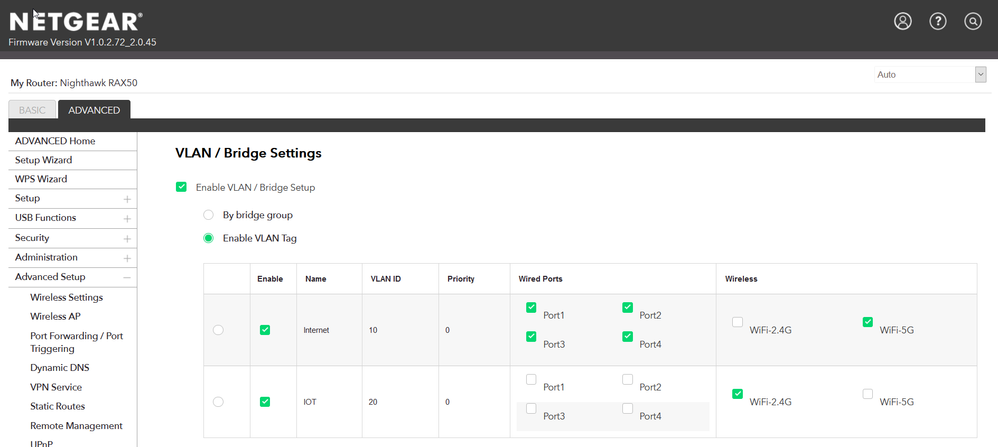

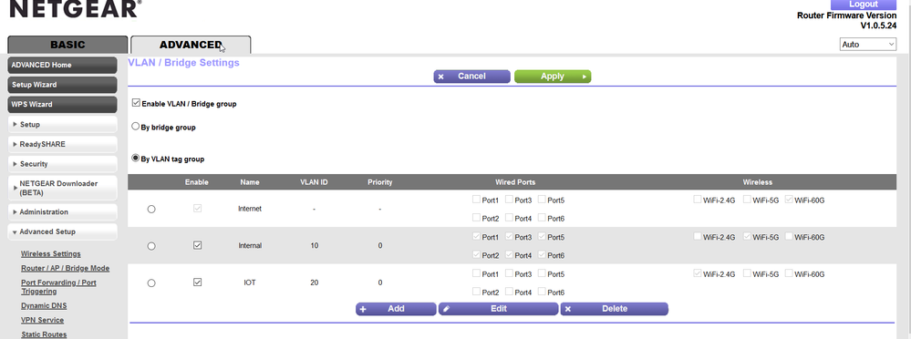

Not sure what you ask here - confused by these newer Orbi offering dedicated Internet, IPTV, and IoT VLANs? This isn't the same basic thing I'm drawing here. Not aware these newer consumer Orbi are supporting configurable many-to-one NAT routes sophisticated small business routers and security appliances do. Sorry, if I sound frustrated: Netgear ignored my proposal providing a design for such a router. So it came as it had to come, they implemented the minimum (very fractional) of they understood and can in the from of the vary basic
MultiWANDualWAN PR60X, Nice hardware, but by far not what I expected in this class. Check the RTFM 8-/These are VLAN-tags in use on the carrier side, in the OP case by this ISP unknown to me.
What Netgear has implemented is a bridge, bringing (==bridging) the traffic of one of these VLANs to a physical port the user can use to connect a IPTV SetTop box for example. In the case of IPTV it's done because most of the consumer network equipment is not VLAN-aware. The ISP can assign an IP address by DHCP or the like, so the SetTop box is able to receive the IPTV Multicast IGMPv2 or IGMPv3 from live TV channels. Very different VOD (video on demand) is pure UDP unicast. Its done on a CGN (carrier grade NAT) method, for simplicity usually on IPv4 RFC1918 addresses.
The VLAN tags only exist on the ISP network, and don't make it to the user network
Ignore that on these examples its name IoT. usually it's plain IPTV:
Like you can get Internet (in fact the NAT router WAN Internet VLAN), you can also assign a dedicated port for IPTV.
