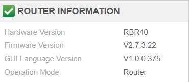

- tekn0684Oct 13, 2021Aspirant
issue: Goes offline all devices mobile, PC also game console when this comes up in the router log.
[WLAN access rejected: incorrect security] from MAC address b0:fc:0d:0c:40:11, Tuesday, October 12, 2021 12:24:43
My router info above, I have two attennas including the router. Works fine about 3 or 4 years now, and suddenly security issue as i posted above started to pop up in the logs. reason looking at the router logs was everytime this happens the whole network goes offline for about a minute or more, if streaming I get cut off instantly and it became annoying.
on my game console had switched the NAT time to my time zone and no more issues, thank you to this post for all your help.
- FURRYe38Oct 13, 2021Guru - Experienced User
Be sure the device has the correct wifi pass work.
What security mode are you using on the Orbi RBR? WPA mixed mode? WPA2 AES only?
Has a factory reset and setup from scratch been performed since last FW update?
