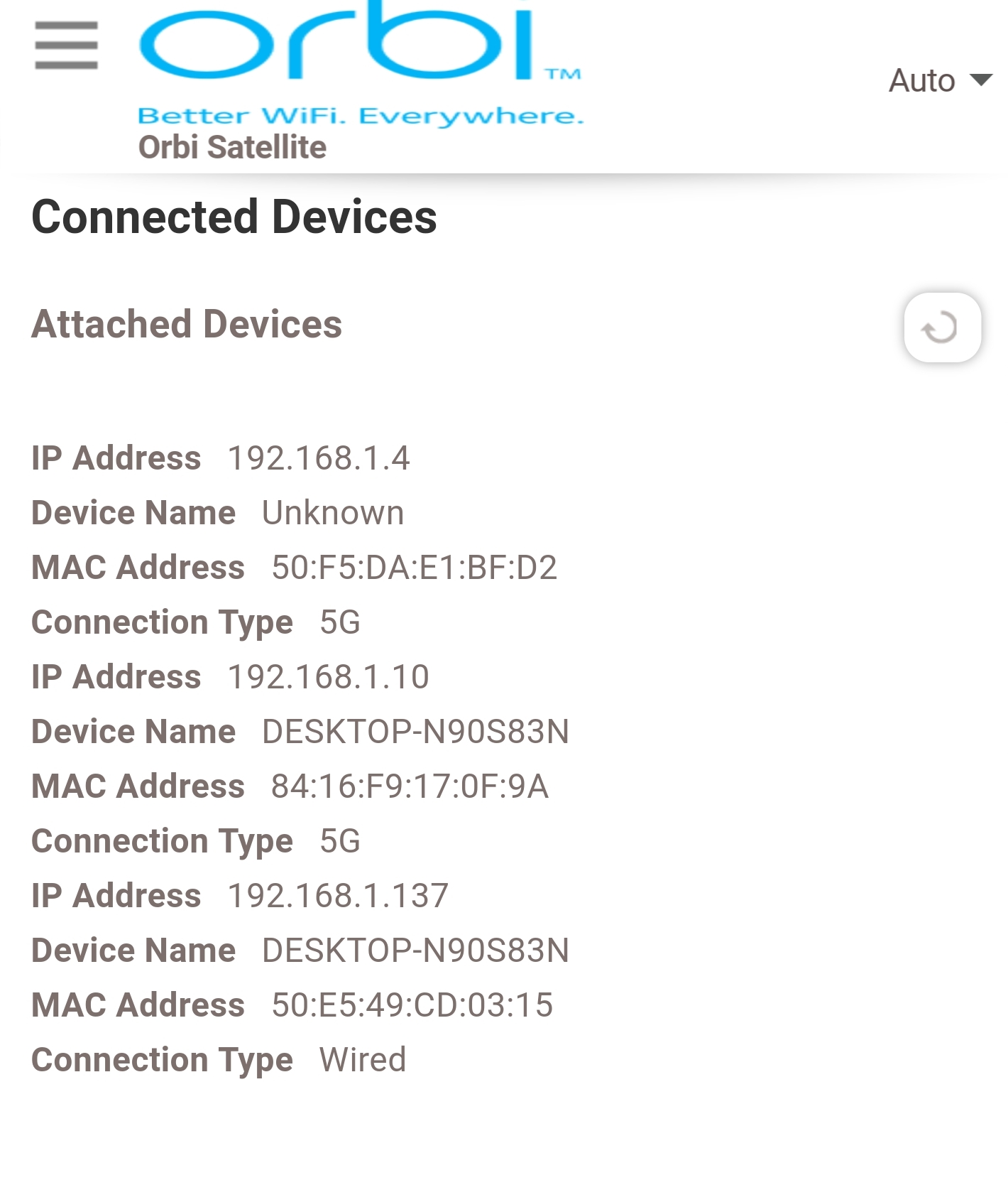

- Samt2992Mar 16, 2018AspirantYes, it's USB 3 and on the 5ghz band. Logging onto the satellite itself, I can see that the desktop is connected to it via wire and wireless.
