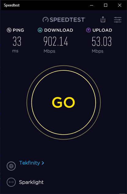

However, my PC (which is connected by ethernet cable to the RBR50) can achieve speeds around 900 mbs using fast.com and speedtest.net. My PC can also achieve 900 mbs when connected by ethernet cable to the gateway.
