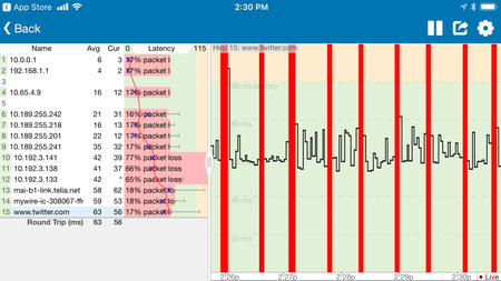

My Orbi satellite and router are running on firmware 2.1.1.16 Today I noticed that my VoIP calls, web browsing and online gaming all hang at the same time. This prompted me to monitor the stability ...

I betting it has something to do with the wireless signal since connecting a computer via ethernet straight to the Orbi router yields flawless performance on the same test. This discards devices flooding the network or routing issues in my mind.

I did some experimentation and found that INDEED the Orbi router and satellite are interfering with each other. For my testing, I shutdown the sattelite unit completely leaving only the router unit operating. Without changing anything else, I ran my original test and came up with this:
The packet loss pattern is now gone completely. For futher testing I stressed the WiFi network with VoiP, online gaming and web browsing simultaneously with excellent results. Everything ran smoothly just as it should.
