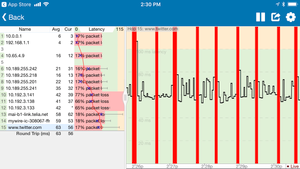

My Orbi satellite and router are running on firmware 2.1.1.16 Today I noticed that my VoIP calls, web browsing and online gaming all hang at the same time. This prompted me to monitor the stability ...
- Jan 06, 2018
After a few hours, the packet loss came back even after the change I made. Long story short: I ended up downgrading back to V2.0.0.74 where the issues is gone entirely. Beamforming and Fast Roaming are enabled in my configuration without issues. I hope this helps somebody.

I did some experimentation and found that INDEED the Orbi router and satellite are interfering with each other. For my testing, I shutdown the sattelite unit completely leaving only the router unit operating. Without changing anything else, I ran my original test and came up with this:
The packet loss pattern is now gone completely. For futher testing I stressed the WiFi network with VoiP, online gaming and web browsing simultaneously with excellent results. Everything ran smoothly just as it should.
