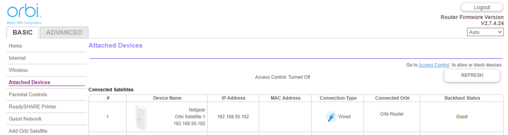

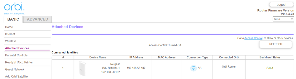

I was curious about this aswell and wanted to see if the ARP storm was still happening on my 50 series.
Got the RBS wirelessly connected to the RBR first:
The first Down green arrow seems to be interactions of the browser with the RBRs web page as I was on the Connected Devices page and I presume it's updating at these intervals. The 1st Left green arrow is the browser logging into the RBS web page to check status. I logged off soon after. The 2nd Left green arrow me logging out of the RBRs web page. We don't see any interval checks after this.
I then connect a CAT6 lan cable in between the RBS and RBR and let the RBS do it's thing. After about 2 minutes the RBRs web page finally updated correctly:

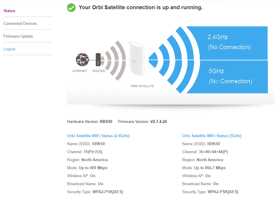

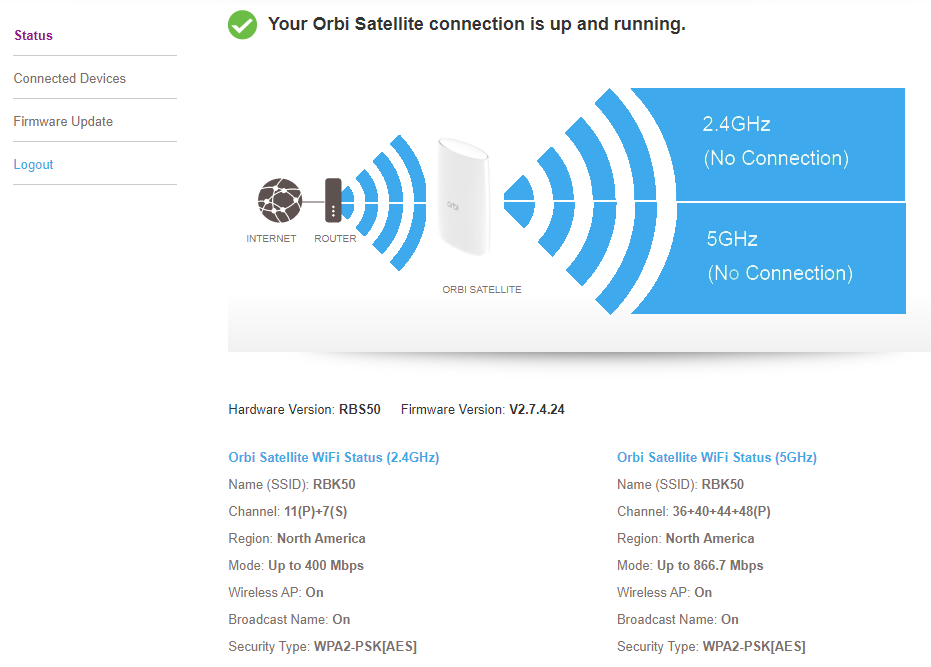

Logging into the RBS web page shows (Gray) wifi icon between the router and satellite inidcating a wired connection:
I saw no ARP storms happening after I connected the ethernet cable to the back of the RBR. The 1st Down green arrow is where I had connected the RBS to the RBR via ethernet cable and was waiting. The Left green arrow is me logging into the RBRs web page and checking the status.
Saw no storms during this time frame.
I disconnected the ethernet cable between the RBR and RBS and let the RBS re-sync over wireless backhaul on it's own and did so successfully. After the RBS was fully back to ready after 3-4 minutes, I connected up a 1Gb non managed LAN switch (HP J9794A) to the back of the RBR with CAT6 and connected my wired PC to this switch as well. I connected the RBS ethernet cable to the back of the LAN switch. I watched the switches LED and the network activity monitor. I waited for about a minute then logged into the RBRs web page. The RBS had connected via ethernet and status showed as Wired as seen above. Again, saw no indications of any ARP storm happening after connecting the RBS via ethernet to the LAN switch.

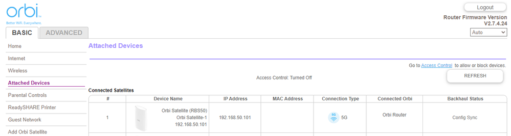

I emulated a power brown out by pulling the RBR and RBS power adapters for 30 seconds then plugged back in. Montiored the switches LED and my netwrk monitor app for any ARP storms.
I logged in to the RBRs web page and RBS was in Config Sync status:
After about a minute or more, I noticed my network app saw a short ARP storm at the Left red arrow, that only lasted about 30 seconds then stopped:

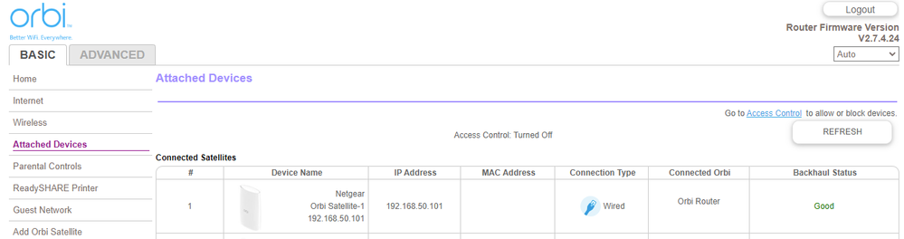

Giving it a few more minutes the RBS successfully synced on wired with Good status on the RBRs web page:
Seems that maybe a ARP storm could be seen during a power outage and back ON across the system, however, giving the system time to come to full ready and after the storm passes, the system is working as expected in this configuration.
