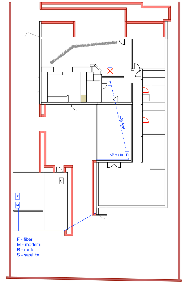

I have an older house, circa 1950 with plaster walls. I have the RBR50 near the middle of our house. I am trying to setup the RSR50 satellite on the far side of one wall about 25 feet from the router. It does not get a good signal. On the near side of the wall about 20 feet from the router it's fine but then some devices at the far end of the house get really poor signal.
I have the basic default configuration with daisy-chain and MIMO enabled. I have read a few posts that suggest that turning one or both of these off may help though not sure exactly why.
The Orbi is in AP mode as my fiber modem is the router because of some network gear i have in the garage that is wired to that router.
Attached is my house - the grey lines near the top are the drop outs when the satellite is on the near side of the wall.
Any suggestions on how to improve range and performance are welcome.

Turning off daisy chain made a dramatic improvement to throughput. With enabled, i was getting ~40 Mbps on devices connected to the satellite. With disabled, I am getting 500-600 Mbps...
