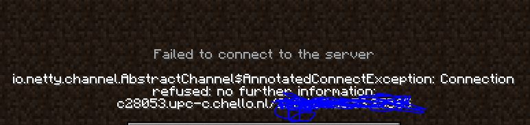

Hi! I have recently been strugling with port forwarding a "mine os" server that I have created recently. I have port forwarded the port 25565 and port 25575 but I checked the if the port is open multiple times with different websites and every one of them is saying that it is closed. I have been trying to solve this problem for more thank a week now, and I came to the conclusion that my network's firewall is the problem. When I try to connect to my server with my public ip adress it says an error message. You can see the error message in the picture below. I did try the steps that other people have talked about in other discussions, but nothing helped my problem from there. My router is a RBR20, and I have three sattelites connected to it. The machine that I host mine os on is also connected to one of the sattelites with a good connection. I have port forwarded port 25565 and port 25575 with TCP and UDP.

exactly, does "my network's firewall" mean to you?> [...] When I try to connect to my server with my public ip adress it
> says an error message. [...]"Connection refused" normally means that you've reached the
destination system, but no one there is listening at the specified port.

> error message.JPGI saw it the first time. The error message does not say what you did
to get that error message.I'll try again.
