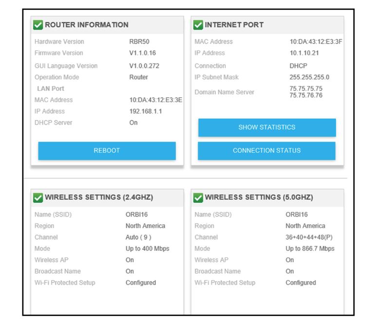

There are two sets of IPs in play here--public WAN addresses and private LAN addresses.
The public WAN IP address of the Orbi router should be shown under the "Internet Satus" display. See attached screen shot from the user's manual. Your No-IP dynamic DNS must resolve to this WAN IP, or port forwarding will not work. You should also see the same WAN IP if you go to http://www.whatsmyip.org from a device connected to Orbi.
Your DVR will have a private LAN IP when connected to Orbi, something like 192.168.1.25. When you setup your forwarding rule, you must reference the private LAN IP of the DVR as the Internal IP address in the forwarding GUI.
It would help if you posted your IP addresses and some screen shots of what you are entering. You can replace part of the WAN IP address for provacy, e.g. 71.23.XX.125.

It could be a couple things. If your Dratek is doing any routing, you would need to forward ports on both the Dratek and the Orbi. Also check to make sure your DNS entry is updated and accurate.
Log into Orbi and look up its WAN address. If it's not a public IP address, then you have a problem with dual NAT. If it is a public address, try port scanning using the numerical IP address of Orbi's WAN interface instead of the domain name.
Ping your domain name (from a device outside your LAN) and make sure the DNS entry resolves to the WAN IP of Orbi.
