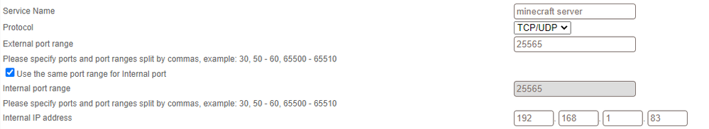

I was running a minecraft server for my friends a few months back, the port was open back then but now when i am trying again it no longer works. I set the port to both TCP and UDP, set internal and external port to 25565, forwarded to a static ip for my server 192.168.1.83, but when i run the server and check if the port is open it says it's closed, and I am unable to connect. The only thing that changed inbetween when the server was running and now is that we changed our modem, but i really don't wan't to buy another one, seeing as we so recently changed to the new one, so if the problem is anything else that I can fix it would be helpfull. For what it's worth I also tried making an online game a while ago with a server and client and was unable to connect outside our local network, at the time I assumed that it was a problem with my code but it could be the same problem.

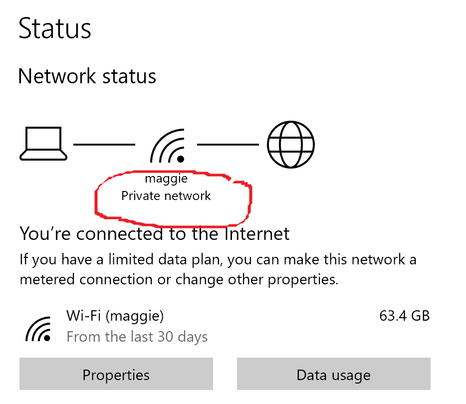

  • If this server is running on a Windows machine, make sure the firewall is not blocking the port.  You need to set your home wireless network as "private" vs. "public" so Windows trusts outside connections.
    Here's one set of instructions: https://www.digitalcitizen.life/how-set-your-networks-location-private-or-public-windows-10/
    You can do this by:
    1. Right-mouse on the network icon in the lower right task bar, select Open Network & Internet Settings.
    2. The network should show as "Private network".  If it says "Public network" then the firewall will block your port from outside devices, including the Orbi's forwarding.
    3. Press the Properties button.
    4. Change Network Profile to Private.
