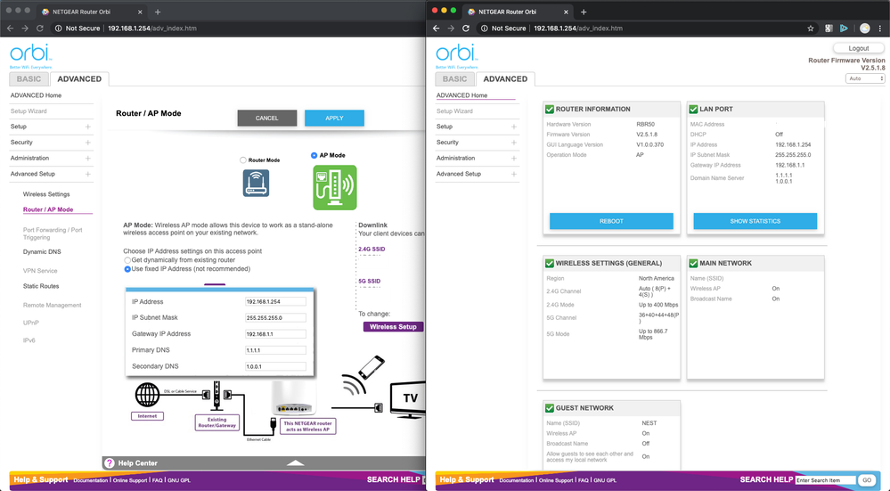

    Here is an example of my Orbi AP config:
