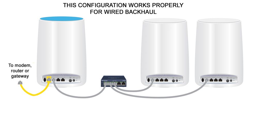

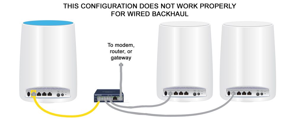

Properly connecting wireless backhaul for Orbi RBR50/RBS50
To anyone who is attempting a WIRED backhaul configuration of their Orbi system (in this case, RBR50 base and two RBS50 satellites), remember that the satellite units must be wired directly into the LAN ports of the base unit, either directly or using a switch. The configuration will not function properly if the satellites are wired at the same layer as the base unit WAN (i.e., yellow) port (e.g., via a switch). That is, the first configuration below WILL work properly, but the second one WILL NOT work properly. Hopefully, this will help anyone striving for a wired backhaul. I did not see this documented anywhere, and it took me some testing to figure this out and confirm it. In my personal situation, I had the base unit located centrally in my house on the first floor, away from my R7800 router (which is in the basement with WiFi disabled on the router, so that only the Orbi is being used for WiFi), with one satellite unit on the second floor, and one satellite unit in the basement. I needed to run two additional Cat6 cables to the base unit location in order to deploy a wired backhaul configuration.

Yes, the star and daisy chain topologies will work, too. However, the point is that, for proper wired backhaul, the satellites need to ultimately connect to the LAN port(s) of the base unit, and not to, for example, a switch or router to which the WAN port of the base unit is connected. This configuration might exist in those who are using Orbi in AP mode with a separate router or gateway connected to the WAN. The practical implication of the need to connect wired backhaul this way is that additional Ethernet cables running to/from the base unit will invariably be necessary should the base unit be located some distance from the router/gateway being used. In my case, I needed to run these additional cables.
