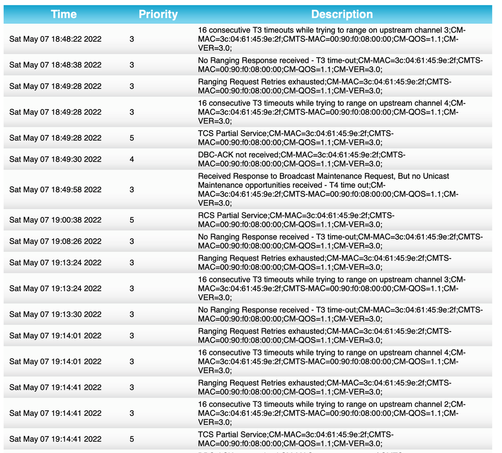

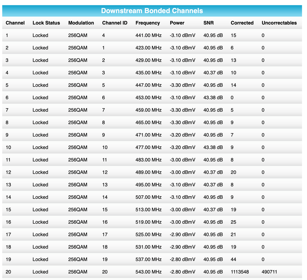

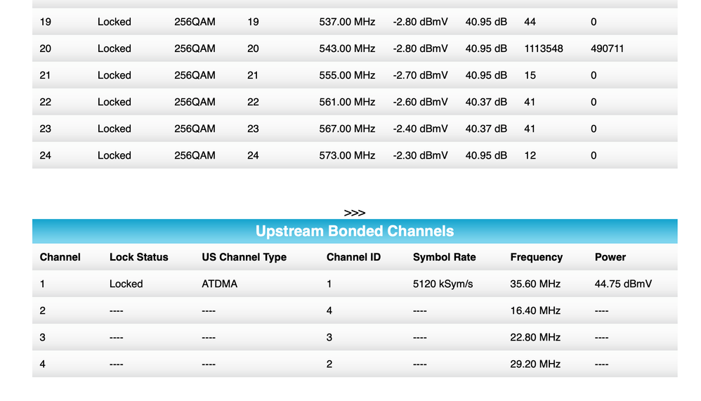

- SantitomilucMay 07, 2022Tutor
Ok I was able to login to my modem and here are the screenshots. I notice that there are some errors and timeouts in the event logs so that is probably the issue I just don't know how to fix it.
