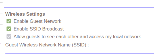

Ok this is now far more serious...Just tested my guest network at it has access to everything on the network, NAS, printer etc.
So the upgrade to 2.7.4.24 breaks the guest networking completely and there is no option to be able to stop seeing other devices on the network when on the guest network - so what is the point of the guest network?
See attached image.

Just been told by netgear support that guest network is not supported in AP mode.
Strange how I have been using for 18months - 2years and now it does not work and not supported even though it is there and present in the interface to configure and select.
That is just plain dangerous and misleading for those that do not double check the capability is working as one would expect.
