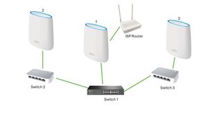

RBK20 - Ethernet backhaul with multiple switches
Hello, I have a RBK20 and this network configuration (image). When I try to connect via ethernet backhaul using 3 switches, devices 1 and 2 works perfectly but device 3 keeps rebooting, even if I co...

Daniel_E wrote:
Hello,
I have a RBK20 and this network configuration (image). When I try to connect via ethernet backhaul using 3 switches, devices 1 and 2 works perfectly but device 3 keeps rebooting, even if I connect device 3 directly to the swtich 1 and then device 3 to the switch 3 It also keeps rebooting. But if I delete switch 3 and connect device 3 directly to switch 1 it works perfectly.
Do backhaul just works with 2 switches o what should I do in this case if I need 3 switches?
