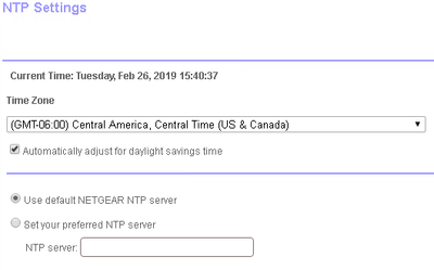

And while you are in there, please let us know the NTP settings under
http://192.168.1.1/adv_index.htm
I suspect you have the lease renewal issue which has a simple fix.
connection time now shows 19:12:00. I didnt check when it was a problem.
I use google dns servers. 8.8.8.8/8.8.4.4.
if the lease issue, shouldnt router also lose internet? I am having problem at satellite. NTP settings are here.
