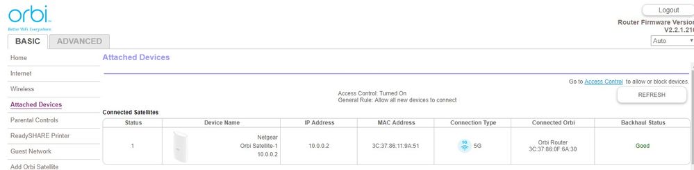

RBK40 v2.2.1.210 Satellite drops internet
My RBK40 was setup more than a month ago and it was updated to latest firmware by that time to 2.2.1.210. Then I had to factory reset my router twice to work properly. Issue is that devicess connecte...

- gr8shoFeb 27, 2019Virtuoso
In the management console you can find some information indicating connection status of the satellite to the base router.

- rsquarev1Mar 13, 2019Tutor
orbilogin.net/debug.htm (router)
192.168.1.2/debug.htm (satellite)
IP may be different for your satellite. you can find the ip in attached devices from orbilogin.net/index.htm
