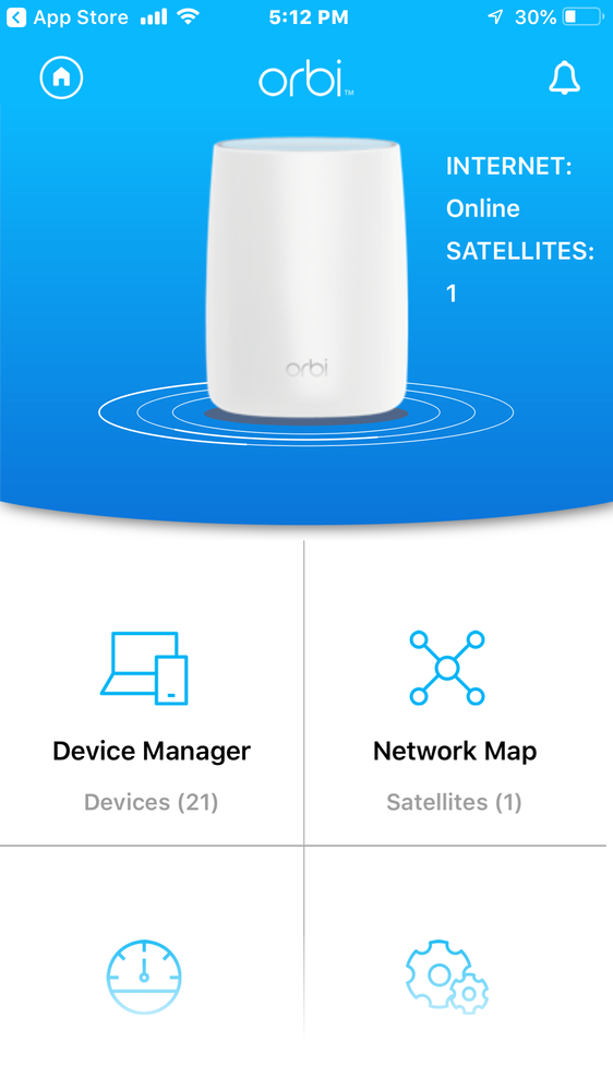

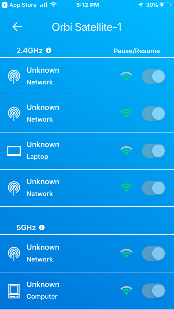

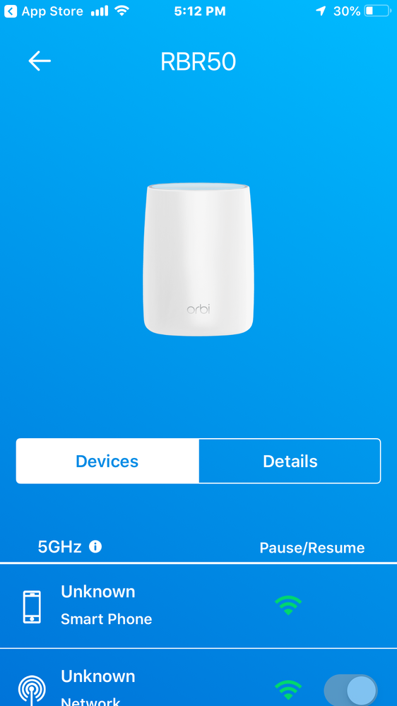

    So after a succesful 7+ days of uptime on a RBK50 system in router mode,
    I change the configuration over to AP mode on the RBR50 and after it was online with a C7800 running in router mode with it's wifi disabled, the Orbi system is online and working in AP modem. Change RBS from wired to wireless backhaul.
    Also the Obi app is also working as well: iPhone 6sP iOS 12
    Only thing I can think of is that there maybe a problem on the 40 series Orbi in AP mode vs 50 series.
    I believe the HW is the same accept for radio connection rates.
