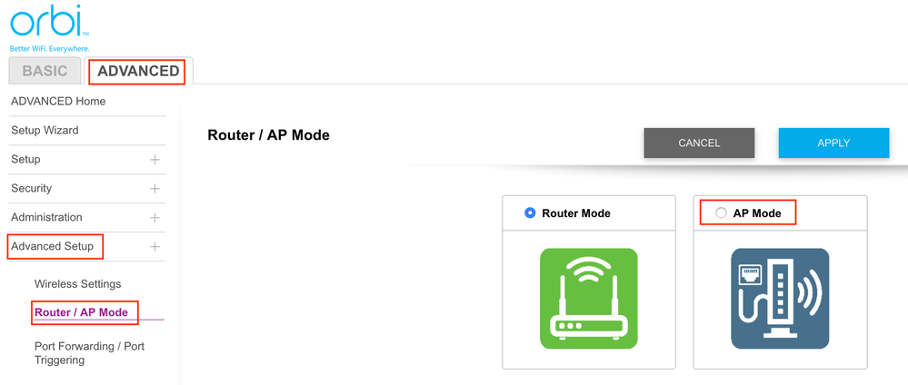

There must be some configuration error I have....sorry for being a bit slow on the more technical stuff.I think that you need to eliminate one of the routers. If it's not possible to change anything in the ROGERS router then please set Orbi in AP mode. You can find this setting here:
- Canadian_SportsJan 11, 2019AspirantGood morning,
Have now tried the AP mode. If I switch off the ROGERS wifi then the signal is so weak upstairs that devices seem to flip between 2.5/5Ghz and TV can’t get a strong signal for Netflix. I ran Speedtest in multiple parts of the house and despite the orbi router showing an internet speed of 55mb the device speed still sits under 20mbs.
There are perhaps a dozen neighbors with wifi I can see. House is approx 1200sq feet per level, 3 levels. Orbi router is hardwired into ROGeRs modem. Orbi satellite sits approx 35’ straight line distance from router.
