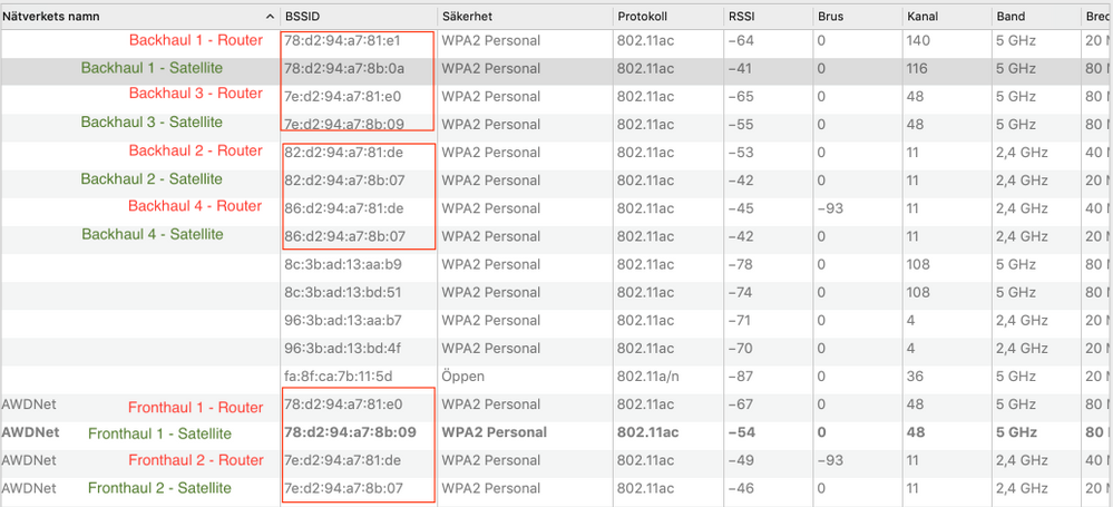

JoeM845, this is what I mean. This is what I see in my network when Daisy Chain is enabled (this is from the built-in wifi scanner in my Macbook):
Once I disable backhaul only the Router Backhaul will be visible while the satellite backhaul networks will disappear. This is a proof that the Daisy Chain setting (on or off) is working correctly and not reversed.

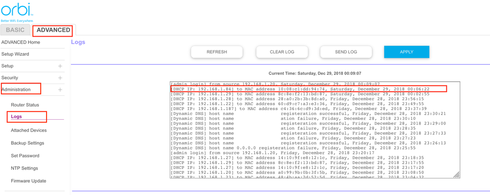

.......5) Is there anyway to get some sort of log/history about the drop-outs?
In the Logs that you find under >> ADVANCED >> Administration >> Logs you should see the DHCP assignment event for devices that drops wifi connection (get de-attached) and the attached again. The DHCP event is the attach event.

It would be nice if I could get log entries that show device associations/disassociatations instead of, or in additiona to, IP assignments. The undocumented log option "Wireless access" looked hopeful, but it either means something else (DHCP IP assignment?) or does not work.

Activation and deactivation is working fine. You can see this by activating Daisy Chain and seeing the hidden networks from the Satellites using a wifi scan. This disappears immediately when you deactivate Daisy Chain. Satellites will never be able to connect to other satellites without seeing a backhaul radio network, so it's impossible that the Daisy Chain setting is reversed! ;)
