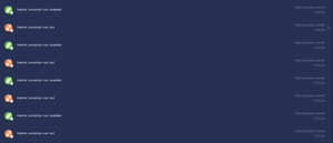

RBK50 Dropping Internet Connection constantly
So currently my setup is as follows: Bell HomeHub3000 -> Orbi RBR50 Router -> Orbi RBS50 Satellite -> Desktop PC It's set up in a wired Daisy-Chain Topography and the Desktop PC is hardwired from th...
- Nov 13, 2021
*Update*
I disabled "Automatically adjust for daylight savings time" and changed my NTP to "time.google.com" instead of the Netgear deault and I have not had a single issue since.
Pretty sad considering I dug this solution up from a post from March of 2019, that had people from March of 2020 posting the same issue and here we are in November 2021 having the same issue multiple firmware revisions later.
