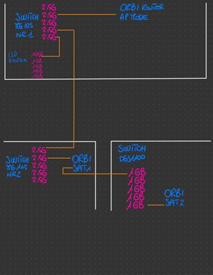

Hi there, I'm in trouble with my new network setup which include a Multigig ISP router (10Gbit GPON) and Orbi RBK50 (1 Router in AP Mode and 2 Sats). My goals are: Keep a multi gig link from ISP ...
- Jan 03, 2023
If your connecting your 2.5Gb PC to the nr2 switch then this will work to maintain the 2.5Gb speed from the host router to the PC.
You can connect the RBR to nr2 here as well, then connect the RBS if you want it ethernet connected to the back of the RBR or use the D-Link switch in between the RBR and RBS for this segment of the chain.
You could connect the RBR to nr1 switch then behind the RBR, directly connect the RBS or connect the DLink switch behind the RBR then connect the RBS to the DLink switch in this segment.

There is something I'm missing here. The only real difference I can see from my old config and new is that Orbi Router is connected to ISP router and not direct to the Switch. Following your suggestion if I put another Zyxel MG105 I can do the magic?
Something like that:
ISP Router ---> MG105 nr1* ---> MG105 nr2** --->DGS-1100***
*Zyxel 2,5Gig unmanaged: Orbi Router (AP mode) connected
**Zyxel 2,5Gig unmanaged: Orbi Sat1
***Dlink Managed: Orbi Sat2 connected (it works before with Ethernet Backhaul, I can bypass if needed or replace)
What do you think? It could be ok?

Here updated config, what do you think about? It's going to work for Ethernet Backhaul?
Thx for the time you are wasting helping me
- schumakuJan 03, 2023Guru - Experienced User
if you don't expect this to become kind of a 2.5G wired backhaul it's all fine.
- KiccoLSDJan 03, 2023Guide
schumaku wrote:if you don't expect this to become kind of a 2.5G wired backhaul it's all fine.
No I'm happy with 1G wired backhaul.

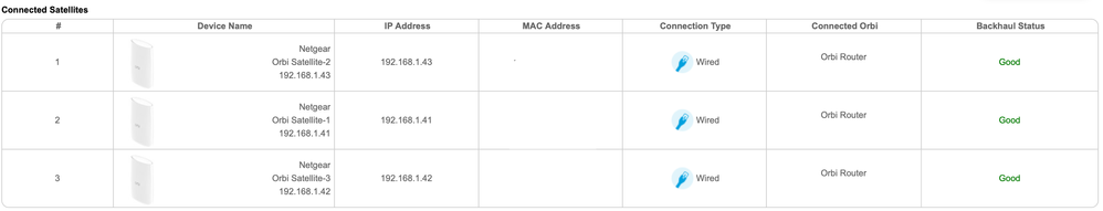

I want to share another point: After linking Orbi Router - Switch Nr1 - and Switch Nr2 I can revert back to the first config posted removing Switch Nr1 and Orbi keep it's wired backhaul.
Maybe it's because Switch Nr2 acquired Orbi Router Mac address and updated its table?
- FURRYe38Jan 05, 2023Guru - Experienced User
Yes and it should persist thru the power cycle as well. Just moved from two switches to one is all. As long as your 2.5Gb is connected to same switch, it should still get 2.5Gb rates as well.
