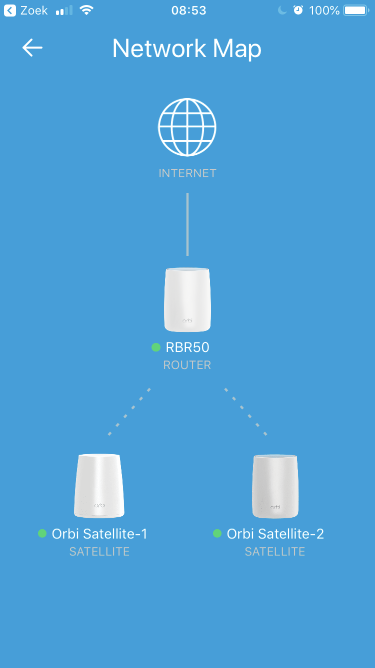

RBK50 With 2 sattelites losing internet speed
As I have mentioned above the RBK50 router with 2 satellites. I have 250Mb internet speed. When I reset the router every device in my house has 250 Mb speed, but after a day it slows down to 40-50 mb....
- Oct 05, 2019Sorry for the delay in answering the questions. I went back to 2.3.5.30 and have now the appletv downstairs as main HomeKit Hub (the others are l stand-by). I have also updated all the apple stuff to 13.1.2. I do have a good connection for a couple of days now. I think the solution was to have the (main) HomeKit Hub connect to the router and not to a satellite. For now on I am happy and I would thank you all for your help.

NowayDude wrote:
As I have mentioned above the RBK50 router with 2 satellites. I have 250Mb internet speed. When I reset the router every device in my house has 250 Mb speed, but after a day it slows down to 40-50 mb. I have already done a factory reset, etc. The satellites connection is good at 5ghz. Can anyone help me?
Since no one has asked or mentioned....this may be your problem ...............FW 2.3.5.30

Hello VAJim,
Thank you for your comment. Also with the older FW’s I had the same problems. Tomorrow I will shutdown the RBS40 and I will tell here what happened. Thank you both for helping me. 👍

NowayDude What type of wired devices do you have connected to Orbi? Do you have any mesh speakers (e.g. Sonos) attached to Orbi?
- NowayDudeSep 25, 2019GuideHello ekhalil,
I have a Synology NAS and IKEA Bridge (lamps) wired. I have 2 unwired Apple HomePods.- NowayDudeSep 25, 2019GuideStrange! It’s middle in the night. Like I said I have 2 satellites and of course the router. The router is downstairs and the satellites on the first floor. I had in my bedroom (upstairs and far away from the router) 250mb connected 5ghz to the router. Now I am at another room 1 1/2 m form the router and I have also 250mb connected to the satellite upstairs.
