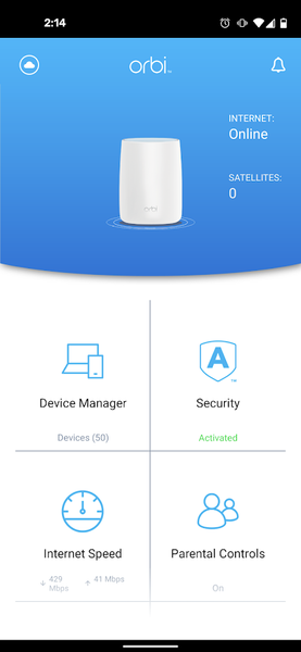

RBK53 System Acting Odd Lately
I have an RBK53 system with the RBR50, 2x RBS50's, and a RBS20 I added later. The two RBS50's are hardwired back to the RBR50, while the RBS20 uses a wireless backhual. They have been up and runnin...

Hi - Thanks for the ideas. No, I have not factory reset, and was hoping to not have to go there. I would need a backup of all the settings, and those pages are some that struggle to load.
The devices are all spread out, most with at least one floor of wood construction in between them. They had all been working fine, and coverage had been good. The RBS20 is the most remote, at least 30 feet from the closest other satellite and is currently the only wireless one since I have not routed a wire to it yet. When it is showing in the network map it does bounce between the two other satellites, so maybe 40 feet across one floor - or 30 feet but through one floor.
I have a Netgear CM600 cable modem.
Not sure it really matters, but are the images I attached loading? They look fine in edit mode, but on the post they are just ! icons.
