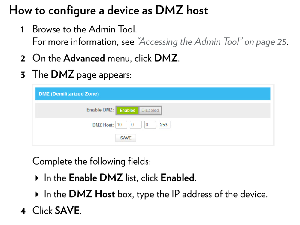

- ekhalilJan 06, 2019Master
Jack_JH wrote:
...........Technicolor TC8305c. The Orbi is plugged into the ethernet port on the router.
I checked the manual for this wireless router and it does not seem to have a bridge configuration.
Since you have Orbi in Router Mode you need to bridge the ISP router or -since it's not possible- configure it's DMZ to go to the Orbi's assigned IP address.
According to the manual of your router here is what you can do:
Please check in Orbi what IP address was assigned to Orbi from the ISP router and use it in the above DMZ configuration.
Your other option is to keep the ISP router as your main router and set Orbi in AP Mode instead.
