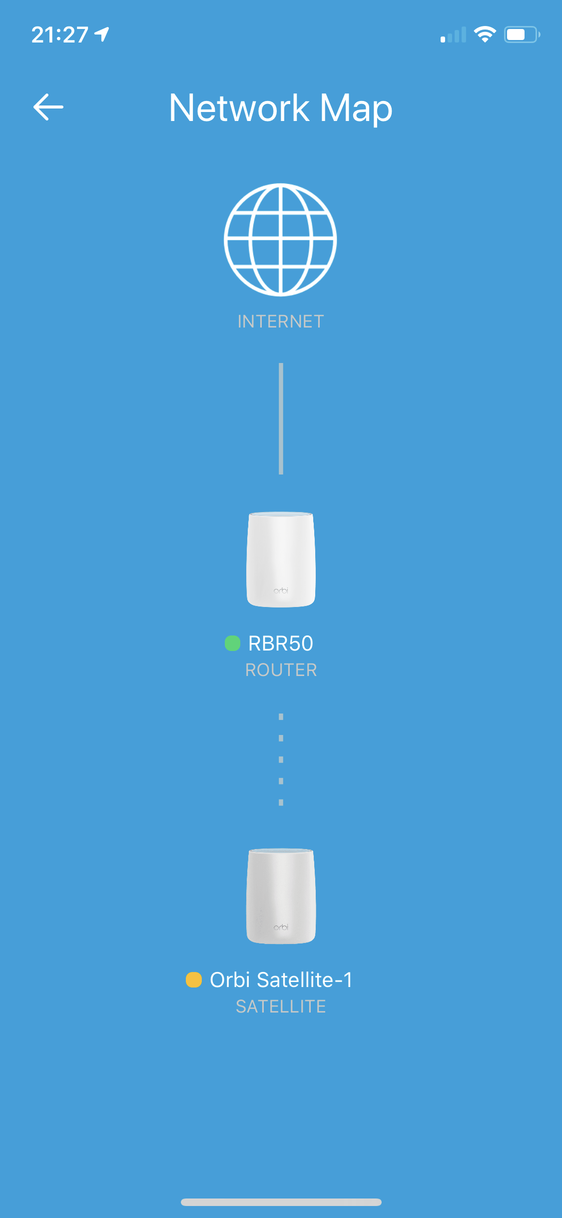

After an automatic firmware update to
2.3.5.30
The backhsul status I noticed is poor.
That’s from the website but on the app the green has changed to orange on the satellite.
They have both been green since installation. . Any suggestions please to correct this issue.
Both have been restarted but not touched sync or reboot.
Thanks
Brian
  • Connecting to the rbr50 via Ethernet on a laptop. Then on the netgear website rebooting the router. Firstly disconnected the satellite then connected it with good backhaul and a green on the app.

    Only the other day I looked at the configuration and the RBS was orange abd I confirmed this via the web site on the RBR
    They are working but the backhaul
    Is low. No colour led exits on the tops.
    They have been working since 2018 no issues.
    They are less than 30 feet apart.
    Thanks again for the message.

    • Signetone8's avatar
      Signetone8
