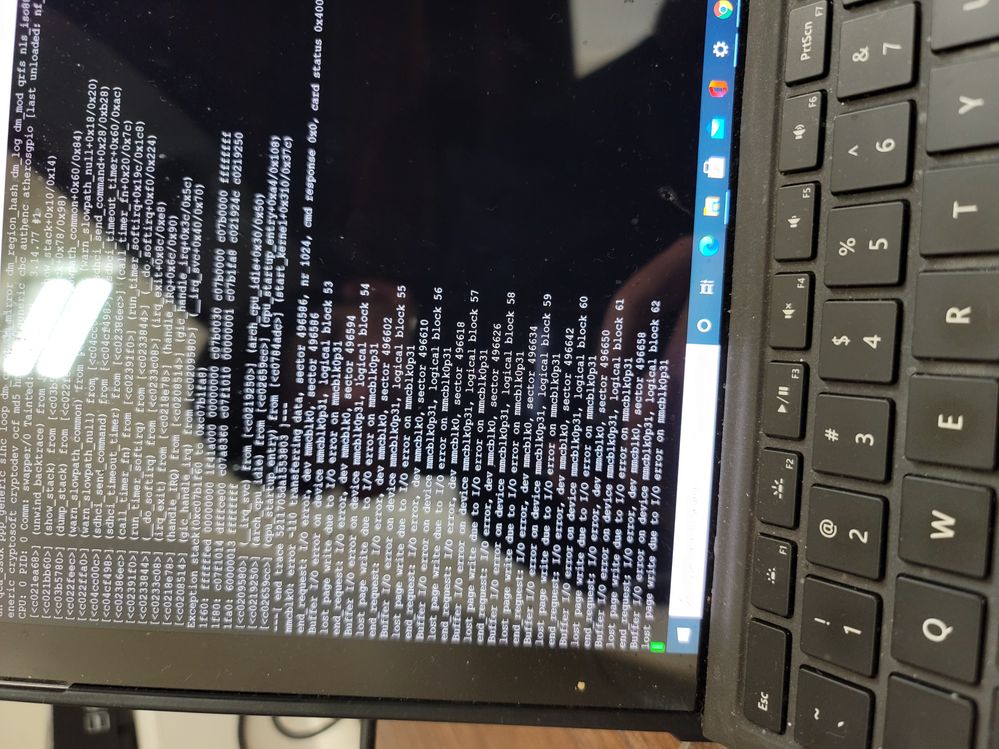

Router began acting weird and having network access errors. Attempted to perform multiple factory resets 30-30-30, etc. etc. Router will not return to its original state (retains my SSID instead of r...

Where are you seeing these error entries?

Loading v104 has the same problem.

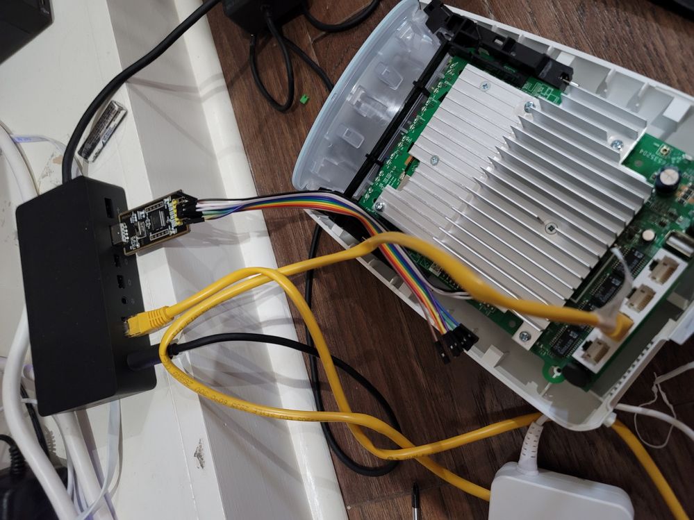

I'm seeing the messages in a PowerShell (PUTTY output from serial port). I see it when it's trying to initialize firmware that I upload to the unit using tftpd64.
Refer to the images posted.
- FURRYe38Aug 04, 2021Guru - Experienced User
Probably something corrupt and needs to be look at by NG.
