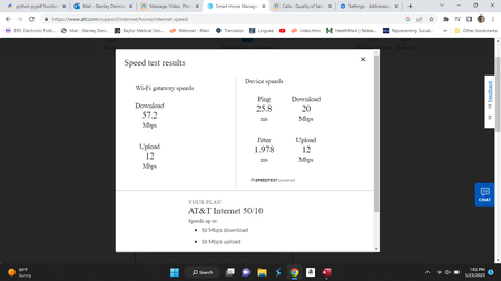

rbr10 poor connection
I have an orbi mesh network set up with my ATT wireless network because my office on the opposite side of the house. The orbi connection speed is terrible. While the orbi app seems to say the speed...

Looks like be the results and what is reported that you pay for is what your getting?
Are we missing something here?
