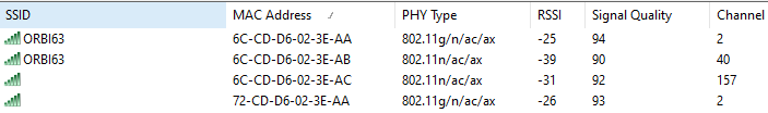

You have discovered a fascinating feature of the Orbi system. There is one hardware MAC address, and the router creates variations of it for each of the WiFi connections (2.4G, 5G, user and "hidden") I deliberately set the test RBR750 to use channels 2 and 40 because WiFi Info View showed that no other nearby WiFi systems are set to those channels:
Notice that all of these WiFi channels have a variation on -CD-D6-02-3E for their MAC adddress.
User facing channels have the SSID ORBI63 and the two 'backhaul' channels have their SSID "hidden"
