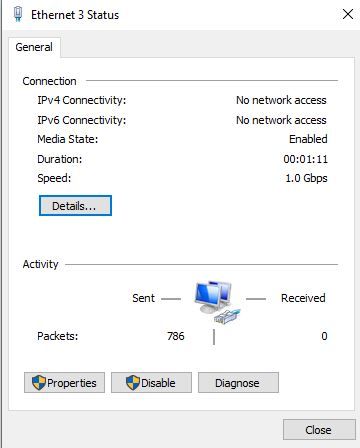

- FryyDec 29, 2021Aspirant
Tried multiple network cables.
For all of them it looks like packets are being sent but none are being received. Sent packets keeps going up, Received never moves from 0.
