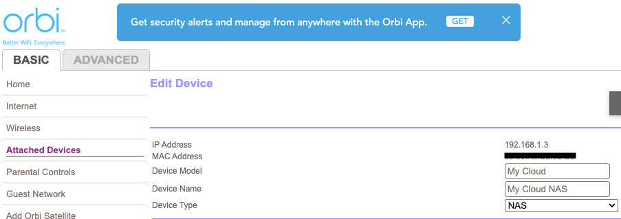

        Don't know what happened, because I didn't do anything, but suddenly I can see the device as connected via both the Orbi app and the web interface.  I can see the NAS's IP address and it's correctly correlated to the MAC address ... but .... I cannot connect to the NAS via that IP address.
        The router has assigned 192.168.1.3 to the NAS and when I try to go to that address with a browser, it never connects.  No error code, no nothing, the browser just sits there contemplating its existence.
