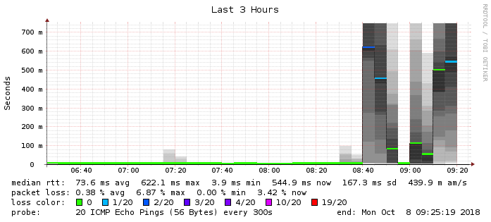

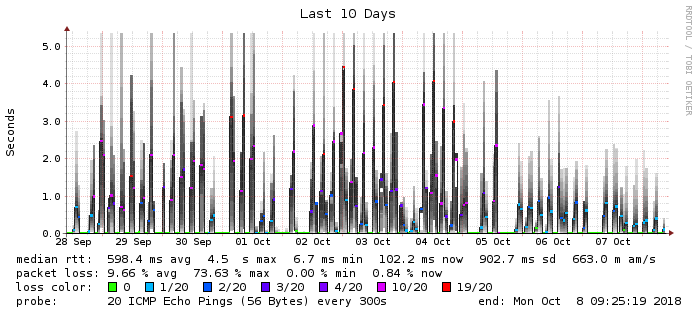

- sjthespianOct 08, 2018Guide
So, after a wekkend of testing various scenarios, I still haven't solved the problem. Upgrading the firwmare helped a bit, the delays dropped to only 5 sec or so when they happen. I have since turned off both satellites, and that appears to have helped a bit more, now the delays are down to less than a second -- but that's still enough to make the wifi painful to use. Here is a current graph of the past three hours from smokeping, along with a 10-day graph that shows how it has decreased during the testing (the 10-day doesn't show the 10s peaks since they get averaged out)
Last 3 hoursLast 10 days
