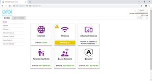

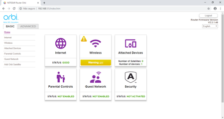

After upgrading the firmware to version 2.3.1.48 the wifi stopped working. On the administration page of the RBR50, the message " " appears. It is not possible to connect wirelessly to the RBR50 w...

So ... I remembered that I can access a windows machine using the terminal server client and I performed what I suggested ... unsuccessfully ... any other suggestions?
- FURRYe38Apr 23, 2019Guru - Experienced User
So a reset from the routers web page and your getting this error message?
I would file a support ticket and have NG review this.
Only other thing I would try would be to try a 30-30-30 reset, manually re-load FW, v48. Factory reset once more after v48 is loaded then see what happens. If your still getting this message then maybe the RBR is bad and needs to be RMAd.
- RCWielewskiApr 23, 2019Aspirant
I used the erase solution on the backup page. After deleting the configuration when trying to access the default ip (192.168.1.1) the message "ERR_CONNECTION_REFUSED" is displayed. When I got home I noticed that the top light went on white all the time. I verified that the RBR50's DHCP server was still working because I disconnected the network cable from the computer and reconnected and the computer got an IP. Only after I disconnected to connect the RBR50 to the power back button was it possible to access the web page again. The configuration wizard page is displayed. The reconnaissance phase of the satellite did not succeed. I tried twice and then ignored this step. Then I set a password for the adm and the name and password of my wifi network. After a while the page was updated and the configuration finished. Unsuccessfully. The error remains. The next attempt is 30-30-30 reset. Could you give me more details on how to proceed this type of reset for this equipment?
