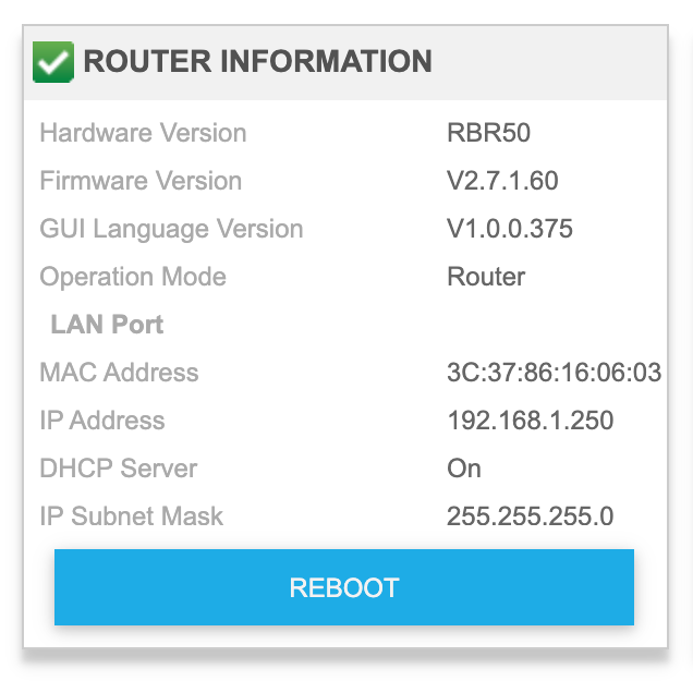

Since I upgraded to firmare V2.7.1.6 I'm having some problems...
My router seems to have its LAN interface configured with IP subnet 192.168.1.0/24  and the router's address is 192.168.1.250
The DHCP range is set to 192.168.1.2 - 192.168.1.254
This seems bad to me - i.e. why is the router's address part of the DHCP range?  I would normally prefer the gateway on my LAN to have address 192.168.1.1.   I would normally use a smaller DHCP range so I can assign static IP addresses outside the dynamic range.
I've recenly strted getting some problems where the wirelss network goes berserk and what looks like some sort of routing loop (pinging the router results in huge packet loss and multi-second ping times)  When this happens, turning off the satellite eventually makes things recover. I suspect that it may be due to the satellite being assigned a DHCP address that's the same as the router.
However, when I try to change any of the above LAN subnet parameters via the web management interface my router just gives me:
400 Bad Request
This server does not support the operation requested by your client.
Is this normal?  If not, does anybody have any suggestions as to how to fix these issues?

    You are correct, the Orbi router is supposed to have IP address 192.168.1.1.  Can you bring up the Orbi web interface, the Advanced Tab, and look at the box "Router Information"?  It actually lists the router as 192.168.1.250?
    If so, this is not right.  I would be tempted to perform a Factory Reset and set it up again.
