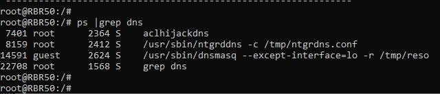

- daverichard4Mar 29, 2020GuideI've suspected that this is a Circle issue for some time. If you telnet to the router you can see there is a DNS hijack process running. I suspect that is Circle hijacking DNS requests to apply it's filtering. Can someone that isn't running Circle check to see if there is a DNS hijack process running? If you telnet to the router and then run "ps |grep dns", one of the process's should contain dnshijack in the name. I'm not at the house to confirm, but it should stand out. I suspect if you aren't running Circle or Armor that you wont see it running. Since Disney has a new version of Circle, I suspect they aren't putting any time into the old version that's running on these routers.
- milenkojmbMar 29, 2020Guide
Here is a copy of the grep with circle and armor not enabled. I left both turned off after my factory default.

My Orbi has never had Disney Circle activated. It shows a process
7225 root 2364 S aclhijackdns
Explanations of how Disney Circle works talk about ARP poisoning, not intercepting DNS.
- tomschmidtMar 29, 2020Virtuoso
I likewise have never activated Circle or Armor. Here are my DNS processes, which includes aclhijackdns:
root@RBR50:/# ps -w | grep dns
1282 guest 2632 S /usr/sbin/dnsmasq --except-interface=lo -r /tmp/resolv.conf -P 4096 --log-facility /tmp/dnsmasq.log --log
7126 root 2364 S aclhijackdns
7877 root 2412 S /usr/sbin/ntgrddns -c /tmp/ntgrdns.conf
13776 root 1568 S grep dns - agregory23Mar 30, 2020Aspirant
