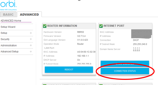

You are probably logging when this happens. It might be useful to also record the IP address lease assigned by the Internet Service Provider. This can be found on the web interface, Advanced Tab, by clicking on Connection Status:

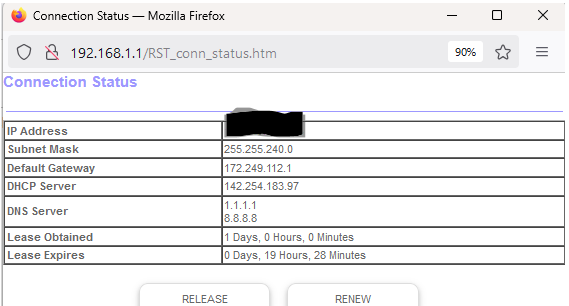

Spectrum assigns me a one day lease (actually 86,400 seconds):
The DHCP protocol specifies that devices attempt to renew the lease when half of the time has expired, so my Orbi will attempt to renew the lease 7 hours and 28 minutes from the time this screen was displayed. It would be an interesting coincidence if the problem occurs at a time when the router should be attempting to renew the lease.
