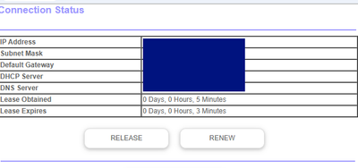

Hi,
Just before closing this thread I wanted to show you the connection status (with my RBR router connected directly to the ONT (so without my ISP modem).
I can see that the lease is very low (5 minutes); is this normal ? Maybe this could have been the cause of my problem (when the ISP modem was still part of my network) : like mentionned already, when I had my problem I could observe that after having rebooted everything, internet connection was ok for a few minutes and then connection was dropped (maybe because of the lease expiration ?)
Yesterday evening I have tested this new configuration and now I have set it up definitively; I will keep an eye on it and check the logs if the problem shows up again.
Thanks
- CrimpOnJan 15, 2025Guru - Experienced User
A 5 minute lease is just "asking for trouble". That said, however, it is very common to do this temporarily when a network reconfiguration is imminent. At the university where I worked, bringing a new building on-line caused a major change to the network infrastructure. If we left the DHCP lease at 24 hours, then it would be a full 12 hours before any change we made became implemented. (some devices would renew just minutes after our change, but any device that had just renewed would not do it again for nearly 12 hours.) So, we would set the DHCP lease to 5 minutes for 12 hours and then make our reconfiguration in the middle of the night when almost no one would be using their computers. In 5 minutes the whole campus would get new IP assignments. No one would notice (because they weren't on line). After verifying "all OK", we would change the lease back to 24 hours and in another 5 minutes, the network would be back to normal.
It could be that the ISP was doing something similar and forgot to go back to a longer lease?
