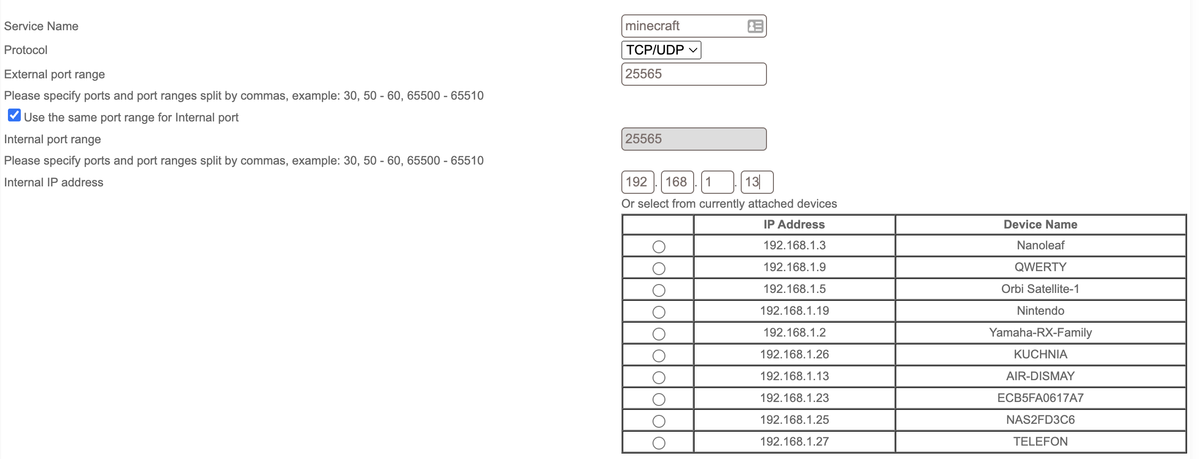

RBR50 Port forwarding not working
Hi, I'm trying to set up an minecraft server for me and my friends at school and i need to port forward port number 25565, but it doesnt work. My router from ISP is in bridge mode, im not using D...
dismay
Feb 08, 2022Aspirant
I also tried on my windows computer, i didnt want to make these rules for firewall so i disabled the firewall and the port is still closed, also i updated the rule on orbi to my pc IP.

- dismayFeb 08, 2022Aspirant
Didnt want to wake up the family by turning the PC on and checking does the minecraft server works, i will try tomorrow. But i found this in logs tab in orbi admin panel. When i look if the port is closed or not this shows up in logs.
[LAN access from remote] from 198.199.98.246:34723 to 192.168.1.6:25565, Wednesday, February 09, 2022 00:05:351
