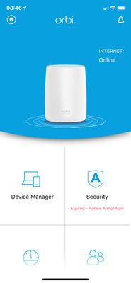

The satellites aren't connecting using the ethernet (powerline) backhaul, only via 5G, and this isn't even getting correctly represented in the Orbi app. According to the app, the satellites aren't connected at all. The network was working fine up to around a week ago and I can't think of any additions, electronically, that have been added to cause this. I can't even blame a firmware update as there hasn't been one for a while!

The satellites aren't connecting using the ethernet (powerline) backhaul, only via 5G, and this isn't even getting correctly represented in the Orbi app. According to the app, the satellites aren't connected at all. ----so you disconnected the powerline? Again, if somethings causing interference on the powerline, it can be switching back and forth from powerline (which is sees as ethernet) and the 5ghz backhaul. This can cause instabliities and the app can be showing the wrong connection. The network was working fine up to around a week ago and I can't think of any additions, electronically, that have been added to cause this.----it doesn't have to be an addition. It can be something as simple as a cell phones power supply going bad that can cause interference. Or a piece of electronics. And that electronics might not go bad for a long time as some electronics don't care about a clean power going to them. but when your using powerline, you need devices that aren't causing feedback into the power system. Its tough to troubleshoot when it does happ. I can't even blame a firmware update as there hasn't been one for a while!
I don't even see the ethernet backhaul. Just the 5G.
