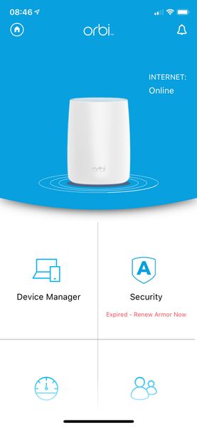

With that in mind, can I get an opinion on the optimum settings for the Orbi router? Attached is a screenshot of the wireless settings.
