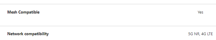

    However, depending on which T-Mobile gateway you have, some  claim to be "Mesh Compatible".  Check this out:
    https://www.t-mobile.com/home-internet/gateway
    The user manual, however, does not appear to contain any information about "Mesh Compatibility".
    https://files.customersaas.com/files/CvUYJmmeNQwM9W6XY24h3g95.pdf
    After quite a bit of searching, I have yet to find anything about "Mesh Compatibility".  So Sad.
