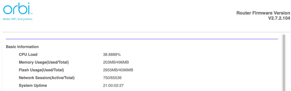

One User Experience/Configuration:
https://community.netgear.com/t5/Orbi/Most-Stable-Orbi-Configuration/m-p/1941087/highlight/true#M97026Ive had good solid operation with my RBK50 on v104 using no telnet modifications:
