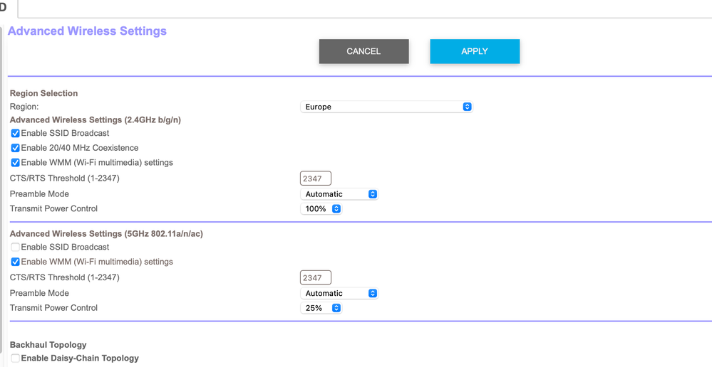

Why is the GUI automatic fw update not finding a new firmware? The current fw is 2.7.4.24, and I am based in Europe. Is this the reason the automatic fw is not working? I want to upgrade ...

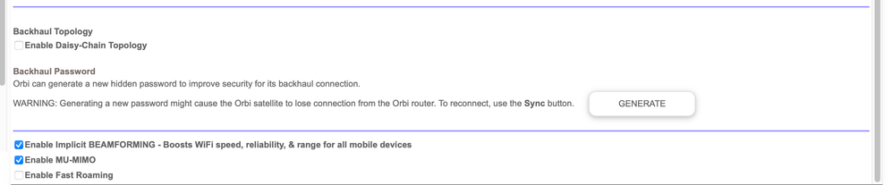

ok. I upgraded satellites, router, and shut down everything and turned it on in the right direction (modem, router, satellites).
Wifi is again working fine for everything except my expensive Pixel 8 Pro. I cannot believe it is not working. It is flapping on and off. I will provide a video and wifi settings here soon. Google is going to start monitoring my phone to troubleshoot this also unless you guys finds a solution fast.
