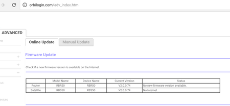

RBR50/RBK50 not in sync
Decided to log on and look at my current status. Satellite is pulsing white. Did a sync, but still the same. Both are at the latest F/W revision v2. 0.0.74. The satellite shows no internet conne...

Welcome to the club. I have the exact same issue as you do. I was told to re-sync the satellite. I did that, and its ring flashed white for about an hour and 40 minutes. Once it quit, I tried the same thing again, and the results were the same: "No Internet". I'm still waiting for a response from DarrenM. My posting is currently on Page 3 and headed lower in the Community.

OK, here is your answer to your problem: power cycle the satellite, and re-sync both the router and satellite. That should clear the "No Internet" issue. It did for me. You can look at my posting to see any further details.
