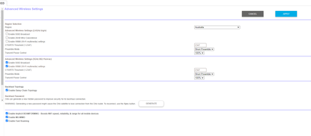

 I am currently experiencing download speed issues when on the WiFi for my Orbi RBR50/RBS50 mesh system. When on a wired connection I am getting download speeds of 900+ Mbps as opposed to when I am on...

p.s. It is unusual to disable the SSID broadcast on the 2.4G frequency band. This will make it very difficult to connect new devices to the system if they support only 2.4G WiFi.
