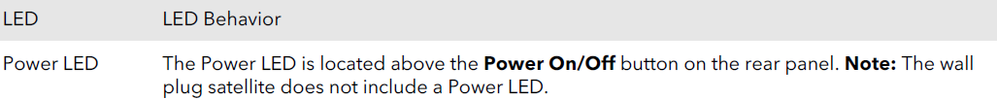

I would definitely keep it in the same room while working on it. Guess you plug it into an extension cord to do the Factory Reset? Does the power LED turn amber and begin to flash? (does it even have a power LED?)

That's a "My Bad" on me. (making assumptions instead of reading the manual)

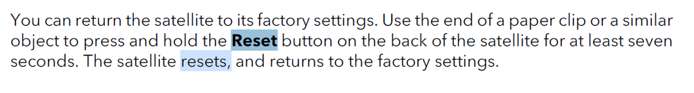

The description of resetting a satellite does not include a similar caveat:
