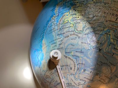

RBS40 Power Adapter PlugHi: I've attached photos of the plug and jack on a RBS40. Notice the jack is not the same as a normal 2.1X5.5 power jack.
JoeRBS40 Jack
