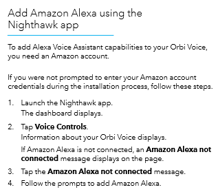

  • CrimpOn's avatar
    CrimpOn
    Poorvdub wrote:
    Also before a link is sent to tell me to post in the Voice forum that i know is out there, When I click the link everyone post it tells me that I am denied permission.
    At one time there was a separate Community Forum for the Voice satellite.  Those discussions were moved into the general forum for the original Orbi WiFi5 products some time ago. (I don't remember when.)
