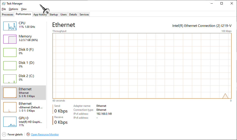

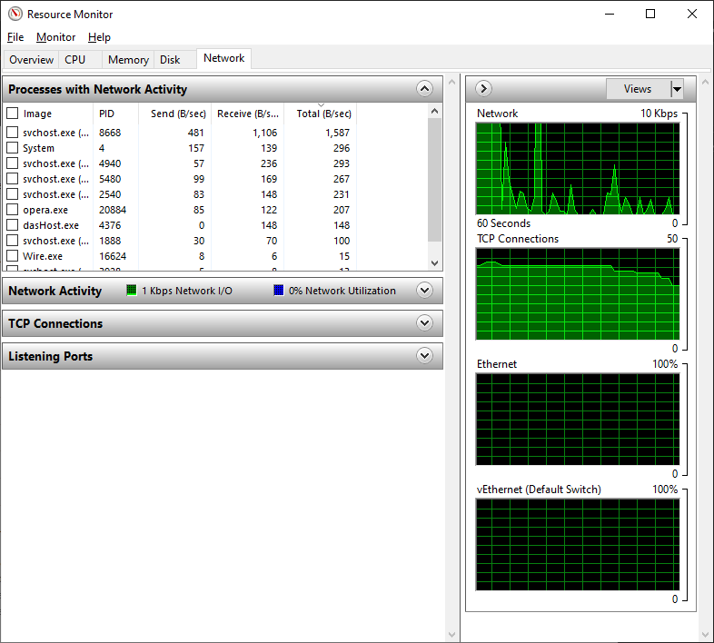

I believe Windows 8-10 introduced built in monitoring tools:
And Resource Manager has been around since NT/XP I think:
- gb2bgSep 30, 2020Aspirant
Thanks for that! I was looking at Network Monitoring Tool 3.x too. Any tips on what specifically to monitor?
- FURRYe38Sep 30, 2020Guru - Experienced User
Just look at ethernet activity or overall activity on the line is all. When the network is stable you shouldn't see much activity. When a ARP storm happens it will be very active and continue to be active until the storm stops.
